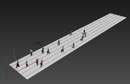

Run the simulation:
  1. On the Simulate panel, click .
    3ds Max shows a progress bar while the simulation calculates.
  2. When the simulation is done, play the animation.
    Initially the flow is empty. Then a single pedestrian appears, and then another.
    As the animation progresses, pedestrians appear more frequently.
    If the Modify panel is open while the animation plays, you can see the Density slider moving as well as the people in the viewport.

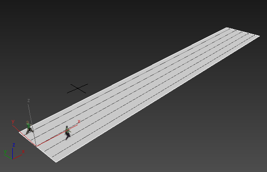

Simulate again:
  1. On the Simulate panel, click once more.
    The animation begins as the previous animation did, but after frame 200 more and more runners appear.
