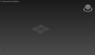

  1. Start or reset 3ds Max and zoom the Perspective viewport out so the grid is relatively small.
    At the default size, the Populate flows are relatively large.

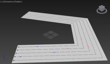

    Create Flow lets you create walkways for the Populate people.
  3. Click in the viewport to start the walkway, then move the mouse and click again to complete the first segment. Go on moving the mouse and clicking to create as many connected segments as you like. To finish, right-click in the viewport.
    The process of creating a flow is similar to creating a Line spline.
    Note: The lines on a flow indicate lanes of pedestrian traffic, while the red and blue marks indicate starting points and walking directions of female and male people, respectively. The arrows at the ends of each line also indicate walking direction.
    If you don't see any lines, there's a problem with the flow. This typically results from too small an angle between adjacent segments. When this happens, undo (Ctrl+Z) and make a new flow with larger angles between segments.
