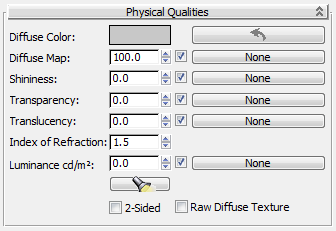

When you create a new Architectural material or edit an existing one, the settings on the Physical Qualities rollout are the ones you are most likely to need to adjust.
  • Material Editor > Architectural Material > Physical Qualities rollout

Diffuse Color
Controls the diffuse color. The diffuse color is the color this material has in direct light. Click the color swatch to display the Color Selector and change the diffuse color.
Set color to texture average
Click to change the diffuse color to an average of the colors in the current diffuse map. (If no map is assigned, this button has no effect.)

Diffuse Map
Click the map button to assign a Diffuse Color map.
While a map is assigned to the material, its name appears as the map button’s label.
  • Amount spinner The spinner at the left sets the amount of diffuse map to use. This value is a percentage: At 100.0, only the map is visible; at lower amounts, the diffuse color shows through; at 0.0, the map is not visible at all.
  • On/off The checkbox between the spinner and the map button is an on/off switch. When on, the map appears in the material. When off, the map does not appear.
Shininess
Sets the shininess of the material. This value is a percentage: At 100.0, the material is as shiny as possible; at lower values, it is less shiny; at 0.0, it is not shiny at all.

Transparency
Controls how transparent the material is. This value is a percentage: At 100.0, the material is completely transparent; at lower values, the material is partly opaque; and at 0.0, the material is completely opaque.

Translucency
Controls how translucent the material is. A translucent object transmits light, but also scatters it within the object. This value is a percentage: At 0.0, the material is completely opaque; at 100.0, the material is as translucent as possible.

Index of Refraction
The index of refraction (IOR) controls how severely the material refracts (bends) transmitted light, and how reflective the material appears. At 1.0, the IOR of air, the object behind the transparent object does not distort. At 1.5, the object behind distorts greatly, like a glass marble. Range=1.0 to 2.5.

Luminance cd/m2
When its luminance is greater than 0.0, the material appears to glow, and if you turn on Emit Energy (see below), it contributes energy to the radiosity solution. Luminance is measured in candelas per meter squared.

Set luminance from light
Obtains the material’s luminance from a light in the scene. Click to turn on this button, then click a light in a viewport. The material’s luminance is set to match the luminance of the light, and the button is turned off once more.
2-Sided
When on, makes the material 2-sided. Applies the material to both sides of selected faces.
Raw Diffuse Texture
When on, excludes the material from lighting and exposure control. This makes the material render with a completely flat look, using the pure RGB values of the diffuse color or map. Default=off.
