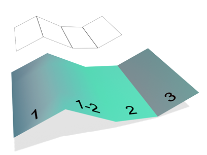

Smoothing blends the shading at the edges between faces to produce the appearance of a smooth, curved surface. You can control how smoothing is applied to a surface so your objects can have both smooth surfaces and sharp, faceted edges where appropriate.
The face labeled “1–2” shares smoothing groups with adjacent faces, so the edges between them are smoothed over in renderings.
The face labeled “3” does not share a smoothing group, so its edge is visible in renderings.
Smoothing does not affect geometry. It affects only the way geometry is colored when rendered.
Smoothing is controlled by smoothing groups, which are numbered groups ranging from 1 to 32. You can assign each face to one or more smoothing groups. When a scene is rendered, the renderer checks each adjacent pair of faces to see if they share a smoothing group, and renders the object as follows:
  • If faces have no smoothing groups in common, the faces are rendered with a sharp edge between them.
  • If faces have at least one smoothing group in common, the edge between the faces is “smoothed”, meaning it is shaded in such a way that the area where the faces meet appears smooth.
