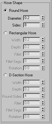

Hose Shape group
Sets the shape of the hose cross section. Default=Round Hose.
- Round Hose
Sets a circular cross section.
- Diameter The maximum width of the hose at the ends.
- Sides The number of sides of the hose. A Sides setting of 3 gives a triangular cross section; 4 gives a square cross section; and 5 gives a pentagonal cross section. Increase Sides for a circular cross section. Default=8.
- Rectangular Hose
Lets you specify different settings for width and depth.
- Width The width of the hose.
- Depth The height of the hose.
- Fillet The amount by which the cross-section corners are rounded. For this to be visible, Fillet Segs must be set to 1 or higher. Default=0.
- Fillet Segs The number of segments across each filleted corner. A Fillet Segs setting of 1 cuts the corner straight across; use higher settings for rounded corners. Default=0.
- Rotation The orientation of the hose along its long axis. Default=0.
- D-Section Hose
Similar to Rectangular Hose, but rounds one side for a D-shaped cross-section.
- Round Sides The number of segments on the rounded side. Increase for a smoother profile. Default=4.
- Fillet The amount by which the two cross-section corners opposite the rounded side are rounded. For this to be visible, Fillet Segs must be set to 1 or higher. Default=0.
