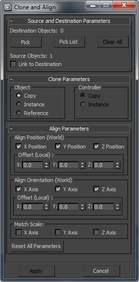

    3ds Max opens the Clone And Align dialog.

The Clone and Align tool takes the form of a non-modal dialog; it remains open while you work in the viewports. While the dialog is active, the results of the current settings appear as a preview in the viewports. Because of the dialog's non-modal nature, you can change the selection of source and destination objects on the fly and see the results immediately in the viewports.
When the dialog focus is lost by activating another dialog or clicking in a viewport (that is, its title bar is gray rather than blue), the preview no longer appears in the viewports. To make the cloned objects permanent, click Apply when the dialog is active.
Source and Destination Parameters rollout
Designate source objects by selecting them in a viewport. If you do this with the Clone And Align dialog open, the dialog loses focus; click the dialog to regain focus and update the settings.
Destination Objects [label]
This read-only field shows the number of destination objects. To change this value, use Pick, Pick List, and Clear.
Pick
When on, each object you click in the viewports is added to the list of destination objects. Click again to turn off after picking all destination objects.
To qualify as a valid destination object, an object must:
  • not have been designated as a source or destination object.
  • be selectable (frozen objects can't be selected).
  • not be a temporary cloned object.
Pick List
Opens the Pick Destination Objects dialog, which lets you pick all destination objects simultaneously, by name. In the dialog, highlight the destination objects, and then click Pick.
Clear All
Removes all destination objects from the list. Available only when at least one destination object is designated.
Source Objects [label]
This read-only field shows the number of source objects. To change this value, keep the dialog open, make sure Pick is off, and then select source objects in the viewports. When you click the dialog, the field updates.
Link to Destination
Links each clone as a child of its destination object.
Clone Parameters rollout
These settings let you determine the type of clone to create, and, if appropriate, how to copy the controller. For details, see Clone Options Dialog.
Align Parameters rollout
The Align Position and Align Orientation group names are followed by the current reference coordinate system, in parentheses, which they use as the coordinate system for positioning and aligning the clones. When the View coordinate system is active, alignment uses the World coordinate system.
The Offset parameters always use each destination object's Local coordinate system.
Align Position group
X/Y/Z Position
Specifies the axis or axes on which to align the clones' position. Turning on all three options positions each set of clones at the respective destination object's location.
X/Y/Z Offset
The distance between the destination object's pivot and the source object's pivot (or source objects' coordinate center). For an Offset value to take effect, the respective Position checkbox must be on.
X/Y/Z Orientation
Specifies the axis or axes about which to align orientation. Turning on all three options aligns each set of clones' orientation fully with that of the respective destination object.
X/Y/Z Offset
The angle by which the source objects are rotated away from the destination object's orientation about each axis. For an Offset value to take effect, the respective Orientation checkbox must be on.
Match Scale group
Use the X Axis, Y Axis, and Z Axis options to match the scale axis values between the source and destination.
This matches only the scale values you'd see in the coordinate display. It does not necessarily cause two objects to be the same size. Matching scale causes no change in size if none of the objects has previously been scaled.
Reset All Parameters
Returns all settings in the Align Parameters rollout to their default values.
