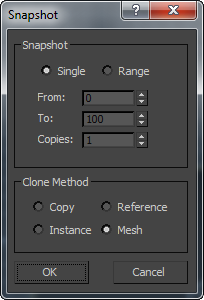

3ds Max opens the Snapshot dialog.
- On the Extras toolbar, click
- Set parameters on the dialog, and click OK.
- Set parameters in the dialog, and click OK.
Interface
Snapshot group
- Single Makes a clone of the geometry of the object at the current frame.
- Range Makes clones of the geometry of the object along the trajectory over a range of frames. Specify the range with the From/To settings and the number of clones with the Copies setting.
- From/To
Specifies the range of frames to place the cloned object along the trajectory.
- Copies
Specifies the number of clones to place along the trajectory. They are evenly distributed over the time period, but not necessarily over the spatial distance along the path.
Clone Method group
- Copy Clones copies of the selected object.
- Instance Clones instances of the selected object. Not available with particle systems.
- Reference Clones references of the selected object. Not available with particle systems.
- Mesh Creates mesh geometry out of a particle system. Works with all kinds of particles.
