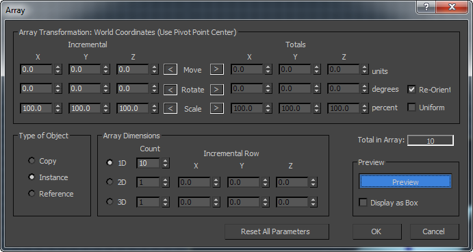

3ds Max opens the Array dialog.
- On the Array dialog, select the type of object to output: Copy, Instance, or Reference).
- In the Preview group, click the Preview button to turn it on.
This lets you see the results of the array operation in the viewports, with changes appearing in real time.
- In the Array Transformation group, click the arrows to set Incremental or Totals array parameters for Move, Rotate, and Scale.
- Enter coordinates for the Array Transformation parameters.
- Indicate whether you want a 1D, 2D, or 3D array.
- Set Count to the number of copies on each axis.
- Enter the appropriate values in the numeric fields for Incremental Row Offsets.
- Click OK.
This area lists the active coordinate system and transform center. It’s where you set the transforms that define the first row of the array. You decide here on the distance, rotation, or scale of individual elements, and along what axes. You then repeat this row in other dimensions to produce the finished array.
You can specify the extent of the transform in increments between each object, or in totals for all objects. In either case, the distances are measured between the pivot points of the objects. The arrays occur using the current transform settings, so the group title changes depending on the transform settings.
For each transform, you have the choice of whether to apply the transforms successively to each newly created element in the array or to the overall array. For example, if you set Incremental
X
Move to 120.0 and Array Dimensions
1D
Count to 3, the result is an array of three objects, each of whose transform centers is 120.0 units apart. However, if you set Totals
X
Move to 120.0 instead, the three elements are spaced 40.0 units apart for a total array length of 120.0 units.
Click the left or right arrow button for Move, Rotate, or Scale to indicate whether you want to set Incremental or Total array parameters.
Incremental and Totals settings are toggles for each transform. When you set a value on one side, the other side is unavailable. However, the unavailable value updates to show the equivalent setting.

Type of Object group
Determines the type of copies made by the Array function.
- Copy (The default.) Arrays copies of the selected object to the specified position.
- Instance Arrays instances of the selected object to the specified position.
- Reference Arrays references of the selected object to the specified position.
Array Dimensions group
Lets you add to the Array Transformation dimension. The additional dimensions are positional only. Rotation and scale are not used.
- 1D Creates a one-dimensional array, based on the settings in the Array Transformation group.
Count Specifies the total number of objects along this dimension of the array. For 1D arrays, this is the total number of objects in the array.
A one-dimensional array
- 2D Creates a two-dimensional array.
Count Specifies the total number of objects along this second dimension of the array.
X/Y/Z Specifies the incremental offset distance along each axis of the second dimension of the array.
A two-dimensional array, with 1D Count=7 and 2D Count=4
- 3D Creates a three-dimensional array.
Count Specifies the total number of objects along this third dimension of the array.
X/Y/Z Specifies the incremental offset distance along each axis of the third dimension of the array.
A three-dimensional array, with 1D Count=10, 2D Count=6, 3D Count=3
Incremental Row Offsets: The offset fields become available when you choose a 2D or 3D array. These are distances along any of the three axes of the current coordinate system.
- If you set a Count value for 2D or 3D, but no row offsets, the array is created with overlapping objects. You need to specify at least one offset distance to prevent this.
- If some objects appear to be missing from the array, it is possible that some objects have been created exactly on top of other objects in the array. To determine whether this has occurred, use Select By Name to see the full listing of objects in your scene. If objects are on top of one another and you don't want this effect, click Ctrl+Z to undo the array, and try again.
- Total in Array
Displays the total number of entities that the array operation will create, including the current selection. If you're arraying a selection set, the total number of objects will be the result of multiplying this value times the number of objects in the selection set.
Preview group
- Preview
When on, viewports display previews of the current array settings. Changing a setting updates the viewports immediately. If the update slows down feedback with large arrays of complex objects, turn on Display As Box.
- Display as Box
Displays the array-preview objects as bounding boxes instead of geometry.
- Reset All Parameters
Resets all the parameters to their default settings.
