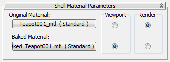

    • In the Compact Material Editor, the Shell Material Parameters rollout is immediately visible.
    • In the Slate Material Editor, drag the sample slot into the active View as an instance, then double-click the Shell mode so you can see the material’s parameters.
Interface
Original Material
Displays the name of the original material. Click the button to view that material and adjust its settings.
Baked Material
Displays the name of the baked material. Click the button to view that material and adjust its settings.
In addition to the coloring and maps used by the original material, the baked material can include shadows from lighting, and other information. Also, a baked material has a fixed resolution.
Viewport
Use these buttons to choose which material appears in shaded viewports: the original material (upper button) or the baked material (lower button).
Render
Use these buttons to choose which material appears in renderings: the original material (upper button) or the baked material (lower button).
