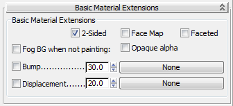

Basic Material Extensions rollout
2-Sided
Makes the material 2-sided. Applies the material to both sides of selected faces.
Face Map
Applies the material to the faces of the geometry. If the material uses maps, it requires no mapping coordinates. The maps are applied automatically to each facet of the object.
Faceted
Renders each face of a surface as if it were flat.
Fog BG when not painting
When the Paint is disabled (that is, the Lighted toggle is off), the painted areas of the material are the same color as the background. This toggle, when on, lets the background in paint areas be affected by fog between the camera and the object. Default=off.
Opaque alpha
When on, the alpha channel is opaque even when the Ink and Paint components are disabled. Default=off.
Bump
When on, enables the Bump map. Use the numeric setting to control the bump amount and the map button to assign a Bump map.
Displacement
When on, enables the Displacement map. Use the numeric setting to control the displacement amount and the map button to assign a Displacement map.

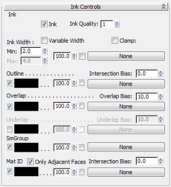

Ink Controls rollout
Ink is the linework, the outlines, in the material.
Except for Ink Width, each of the ink components has an on/off toggle and a color swatch. Click the color swatch to display a Color Selector and change the ink component's color. Each ink component, Ink Width included, also has a set of map controls.
Ink
When on, the rendering is “inked.” When off, no ink lines appear. Default=on.
Left: Rendering with ink
Right: Ink turned off
Ink Quality
Affects the shape of the brush and the number of samples it uses. When Quality equals 1, the brush is a “+” shape, and samples are taken over an area of 5 pixels. When Quality equals 2, the brush is octagonal and the samples are taken over an area of 9 to 15 pixels. When Quality equals 3, the brush is nearly circular, and samples are taken over an area of 30 pixels. Range=1 to 3. Default=1.
Tip: For most models, increasing the Quality value introduces only a very subtle change, and can take considerably longer to render. Do so only when a sub-object's ink shows too many artifacts in the finished rendering, using the default Ink Quality. (Don't rely on the ActiveShade preview, which tends to be aliased.)
Ink Width
The width of the ink, in pixels. This is specified by the spinner labeled Min (minimum) unless Variable Width is on. When Variable Width is on, the Max (maximum) spinner is also enabled, and the ink width can vary between the minimum and maximum values. Default: Min=2.0, Max=4.0.
Left: One-pixel ink width
Middle: Five-pixel ink width
Right: Ink width varies from one to five pixels.
Variable Width
When on, the ink width can vary between the minimum and maximum Ink Width values. Ink with Variable Width looks a bit more streamlined than ink with a constant width. Default=off.
The thickness of ink can be mapped.
Left: Thickness mapped with a gradient map
Right: Thickness mapped with a noise map
Clamp
When Variable Width is on, sometimes the scene lighting causes some ink lines to become so thin they nearly disappear. If this happens, turn on Clamp, which forces the ink width to always remain between the Min and Max values, regardless of the lighting. Default=off.
Outline
The ink where the outer edges of the object appear against the background or in front of a different object. Default=on.
Left: Rendering the outline only
Right: Rendering only the overlap and underlap
  • Intersection Bias Use this to adjust artifacts that might appear when two objects intersect each other. In effect, this moves the inked object closer to the rendering point of view, or farther away, so Ink 'n Paint can decide which object is in front. Positive values push the object away from the point of view, negative values pull it closer. Default=0.0.
Overlap
The ink used when a portion of an object overlaps itself. Default=on.
  • Overlap Bias Use this to adjust artifacts that might appear in ink that traces the overlap. It says how far the overlap has to be in front of the rear surface for Overlap ink to turn on. Positive values push the object away from the point of view, negative values pull it closer. Default=10.0.
Underlap
Similar to Overlap, but applies ink to the farther surface rather than the nearer one. Default=off.
  • Underlap Bias Use this to adjust artifacts that might appear in ink that traces the underlap. It says how far the underlap has to be behind the front surface for Underlap ink to turn on. Positive values push the object away from the point of view, negative values pull it closer. Default=0.0.
SmGroup
The ink drawn between the boundaries of smoothing groups. In other words, it inks the edges of the object that have not been smoothed. Default=on.
Mat ID
The ink drawn between different material ID values. Default=on.
Tip: If two Ink 'n Paint materials overlap in the viewport, and both have Mat ID on, you will often get a doubly thick ink line where they overlap. To correct this, turn off the Mat ID component for one of these materials.
Inking the edges between sub-materials
  • Only Adjacent Faces When on, inks the material ID edge between adjacent faces, but not between one object and another. When off, inks the material ID edge between two objects or other non-adjacent faces. Default=on.
  • Intersection Bias When Only Adjacent Faces is turned off, use this to adjust any artifacts that appear at the boundary between two objects with different material IDs. Default=0.0.
Map controls
There are map controls for each of the ink components: Width, Outline, Overlap, Underlap, SmGroup, and Mat ID. These work the same as they do for the material's paint components, as described preceding.
