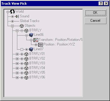

Share Email Facebook Twitter LinkedIn Track View Pick Dialog Open the hierarchy and pick a track to use in the motion clip. Select a Crowd helper. > Modify panel > Global Clip Controllers rollout > New > Choose a GlobalClip object. > Select the object in the list. > Edit > Synthesis dialog > Motion Clips panel > Track View group > New > Track View Pick dialog Track View > Hierarchy > Global Tracks > Block Control > Global Clip Properties (right-click) > Synthesis dialog > Motion Clips panel > Track View group > New > Track View Pick dialog Parent topic: Motion Clips Panel
