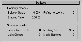

Statistics Rollout (Radiosity)
This rollout lists information about the radiosity processing.
  • Main toolbar > (Render Setup) > Render Setup dialog > Choose Default Scanline Renderer as the active production renderer. > Advanced Lighting panel > Select Advanced Lighting rollout > Choose Radiosity from the drop-down list. > Statistics rollout
  • Rendering menu > Render Setup > Render Setup dialog > Choose Default Scanline Renderer as the active production renderer. > Advanced Lighting panel > Select Advanced Lighting rollout > Choose Radiosity from the drop-down list. > Statistics rollout
Interface
Radiosity process group
Lists the current level of quality and number of refine iterations in the radiosity process.
Solution Quality
The current level of quality in the radiosity process.
Refine Iterations
The number of refine iterations in the radiosity process.
Elapsed Time
The time spent processing the solution since the last reset.
Scene Information group
Lists information on the radiosity processing of the scene.
Geometric Objects
Lists the number of objects processed.
Light Object
Lists the number of light objects processed.
Note: Self-illuminated objects count as one light per face.
Meshing Size
Lists the size of radiosity mesh elements in world units.
Mesh Elements
Lists the number of elements in the mesh processed.
Note: Transparent, 2–sided, and translucent objects' faces are counted twice.
