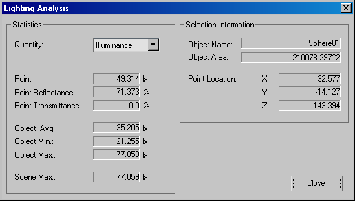

To query light levels, analyze the data, and produce reports, use the Lighting Analysis dialog. This dialog provides rendering data on material reflectance, transmittance, and luminance.
  • Select an object that has radiosity solution information. > Rendering menu > Advanced Lighting > Lighting Analysis
For example, a lighting engineer might need to know if light fixtures in a scene provide an even level of illumination on the walls of a building. The engineer uses the Lighting Analysis dialog after placing the lights in the ceiling and processing radiosity. The engineer inspects the light levels and material reflectance in the scene and then adjusts the brightness of lights, changes units, or reduces material reflectance.
To use the Lighting Analysis tools, a radiosity solution must be calculated and displayed in the scene. For better feedback, use it in conjunction with the Pseudo Color Exposure Control. This tool maps luminances or illuminances to pseudo colors that show the brightness of the values 3ds Max converts.
Tip: You can also export LogLUV TIFF files or PIC files for analysis by other software; do this by using the Lighting Data Exporter Utility.
Interface
Statistics group
Displays the radiosity solution lighting statistics for the object you select.
Quantity
Choose the desired photometric value:
  • Luminance The amount of energy leaving a surface.
  • Illuminance The amount of energy arriving at a surface.
Point
The luminance or illuminance at the point on the object where you clicked.
Point Reflectance
The reflectance of the surface material at the point on the object where you clicked.
Point Transmittance
The transmittance of the surface material at the point on the object where you clicked.
Object Avg
The amount of light intensity for the object as a whole.
Object Min
The object’s minimum luminance or illuminance value.
Object Max
The object’s maximum luminance or illuminance value.
Scene Max
The scene’s highest luminance or illuminance value.
Selection Information group
Object Name
The name of the selected object.
Object Area
The area size of the selected object.
Point Location
The X,Y,Z coordinate of the point on an object you clicked.
