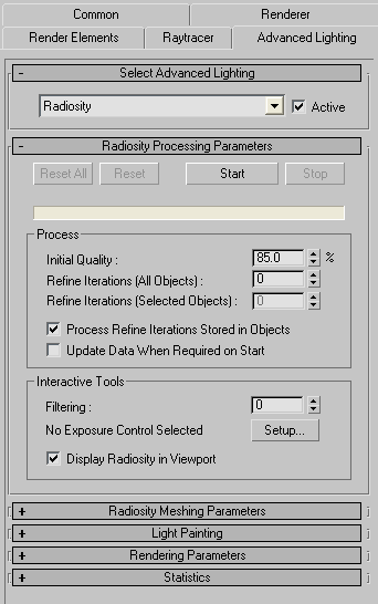

Radiosity is a technique to calculate indirect light. Specifically, radiosity calculates the interreflections of diffuse light among all the surfaces in a scene. To make this calculation, radiosity takes into account the lighting, materials, and environment settings in the scene.
  • Render Setup dialog > Choose Default Scanline Renderer as the production renderer. > Advanced Lighting panel > Choose Radiosity.
  • Rendering menu > Advanced Lighting > Radiosity > Render Setup dialog > Advanced Lighting panel > Radiosity is chosen.
Radiosity processing is distinct from the rendering process. You can render without radiosity. However, to render with radiosity, you must calculate radiosity first.
Once a radiosity solution for a scene exists, you can use it in multiple renderings, including multiple frames of an animation. If the scene contains moving objects, radiosity might need to be recalculated; see Animation with Radiosity.
For an overview of radiosity and how radiosity works in 3ds Max, see Modeling Global Illumination with Radiosity.
For suggestions regarding workflow for using radiosity, see Radiosity Workflows.

  13. Choose Rendering Advanced Lighting Radiosity to display the Advanced Lighting panel with Radiosity chosen as the advanced lighting type.
    The rollouts for radiosity are displayed.
  14. Choose Rendering Radiosity to display the Radiosity panel.
  15. On the Radiosity Processing Parameters rollout, click Start to begin processing radiosity.
  16. To render the scene after radiosity processing completes, click Render.

  7. Choose Rendering Advanced Lighting to display the Advanced Lighting panel. On the Select Advanced Lighting rollout, choose Radiosity as the advanced lighting type.
  8. Choose Rendering Advanced Lighting Radiosity to display the Advanced Lighting panel with Radiosity chosen as the advanced lighting type.
  9. On the Radiosity Processing rollout, under Interactive Tools, click Setup to display the Environment panel where you set exposure controls.

Radiosity controls appear as rollouts on the Advanced Lighting panel of the Render Setup dialog. To choose radiosity, use the Advanced Lighting Panel.
