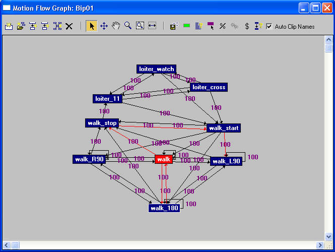

The first step in Motion Flow mode is to add clips in the Motion Flow Graph for use in scripts. Clips represent all or part of a BIP file. Scripts represent different paths through the clips in the Motion Flow Graph. The first clip in the current script is red. Transitions are shown as arrows between clips, red arrows represent the path through the active script. Black transition arrows indicate unloaded scripts. A transition looping back to the same clip represents a cycle or loop.
If the biped is using a shared motion flow, then the title of the graph window will say "*SHARED* Motion Flow Graph", followed by the name of the shared motion flow. Shared Motion Flows are used to control multiple bipeds with one shared motion flow.
By default, minimum motion loss is used to compute transitions. Optimized transitions use an algorithm that uses minimum foot sliding. Optimized transitions take longer to compute but yield very high quality results.

Clips and transitions are given percentages that are used by character studio to generate random scripts. Percentages for clips and transitions are set in the clip dialogs and in the Transition Editor dialog.
You can load many clips and use Create All Transitions to create all possible transitions between the clips. You can then use Optimize Selected Transitions to create optimized transitions. Once the transitions are created, you can quickly create scripts with optimized transitions or generate random motions for a crowd of bipeds.

Use Ctrl+click to add clips. Selected clips are used by Create Random Motion in the Scripts group to start on one of the selected clips based on percentage. If three clips are selected using the default weighting of 100, then each clip has an equal chance of being the start clip.
Show Random Percentages
Displays clip and transition percentages in the Motion Flow Graph window.
Random start clips display in purple and display their probability of starting a random script. This also shows the probability (0–100) that each transition will be chosen. Create Random Motion in the Scripts group uses clip and transition percentages to generate random scripts.
