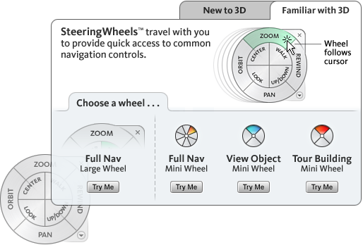

The SteeringWheels ® 3D navigation controls are tracking menus that allow you to access different 2D and 3D navigation tools from a single tool.
SteeringWheels are divided into different sections known as wedges. Each wedge on a wheel represents a single navigation tool. You can pan, zoom, or manipulate the current view of a scene in different ways.
SteeringWheels, also known as wheels, can save you time by combining many of the common navigation tools into a single interface. Wheels are specific to the context that a scene is being viewed in.
The Full Navigation wheel
First Contact Balloon
By default, the wheel is inactive at startup. However, if you enable the Always Show the Pinned Wheel on Start option, the wheel is “pinned” at startup to the lower-left corner of the Perspective viewport. It does not follow the cursor and, when you position the cursor over the wheel, the First Contact balloon for the SteeringWheels opens. The First Contact balloon serves as an introduction to the purpose of the wheels and how you can use them.
