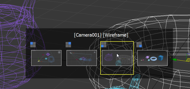

Switching Viewports When Maximized
When a multi-viewport layout is active and a viewport is maximized (toggle with Alt+W), you can switch to other viewports in the layout by first pressing and holding the Windows key (sometimes labeled "Start") and then pressing and releasing the Shift key. This opens an overlay interface for switching to a different viewport:
Overlay interface for changing the maximized viewport
At this point, the next available viewport is highlighted. You can change the highlighting by pressing Shift repeatedly; releasing the key at any time maximizes the highlighted viewport. Alternatively, point to the desired viewport and click the mouse button.

To change viewports when one is maximized:
  1. Press and hold Windows/Start, then press and release Shift.
    This opens the viewport-switching interface.
  2. If necessary, press Shift repeatedly to highlight the desired viewport, then release Windows/Start to maximize the highlighted viewport.
    Alternatively, simply click the desired viewport.
