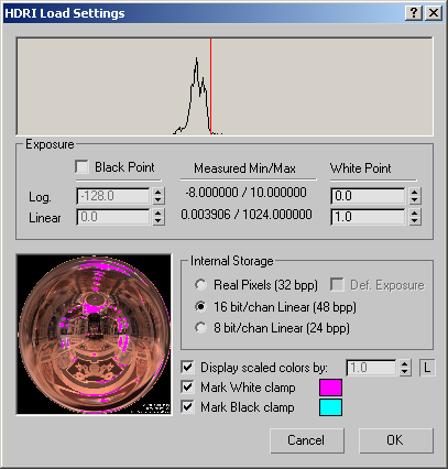

HDRI Load Settings dialog
When you open a Radiance file as a bitmap, the HDR Load Settings dialog appears. This dialog allows you to specify the luminance range to use from the image, and the method for storing the data.
[histogram]
This graph shows the image's luminance values in a logarithmic scale. The red lines indicate the current Black Point and White Point values.
The graph is visible only for luminance levels with substantial representation in the image. In other words, if a luminance level only applies to one or two pixels in the image, there will be no corresponding graph line on the histogram. Compare with Measured Min/Max, which gives the entire range of luminance levels in the image.
In general, the resulting image will have the most dramatic effect when the histogram is used to set the Black Point and White Point range values, rather than using the full range expressed by Measured Min/Max.
Exposure group
Black Point
When this option is turned on, you can set the luminance value that you would like to be treated as the darkest color, or “black”. The value can be set as a logarithm (Log) or as a linear value (Linear). All values below this value will be clamped to black. When this option is turned off, the lowest possible value is used as the Black Point.
Measured Min/Max
Displays the actual minimum and maximum luminance values in the image, expressed as both the logarithmic and linear values. Using these values for the Black Point and White Point will result in the image's full luminance range being used. However, the histogram might show that the majority of the luminance levels fall into a much smaller range.
White Point
Sets the luminance value that you would like to be considered the brightest color, or “white”, either as a logarithm (Log) or linear value (Linear). All luminance values in the image that are above this value will be clamped to white. White pixel values inside HDR files can be much larger than a Linear value of 1.
The image's extended luminance range is used only when the White Point's Linear value is set above 1.0. In other words, setting White Point at or below a Linear value of 1.0 will not use any of the HDR image's special luminance properties, and will give results similar to other bitmap formats such as TIF and JPG.
Log
Sets the Black Point or White Point as a logarithmic value ranging from –128 to 127. Changing this value changes the Linear parameter to the corresponding value.
Linear
Sets the Black Point or White Point as a linear value ranging from 0 to over 1 trillion. Changing this value changes the Log parameter to the corresponding value.
Preview window
Displays the HDR image.
Internal Storage group
  • Real Pixels (32 bpp) Compresses the luminance selections into a color space with 32 bits per pixel. Premultiplied Alpha and Motion Blur do not work with this option.
    Def Exposure When on, the image will load as is without applying any changes to the colors. When off, you can use the parameters in the Exposure group to remap colors. Available only with the Real Pixels option.
  • 16 bit/chan Linear (48 bpp) Compresses the luminance selections into 16–bit color space, at 48 bits per pixel. This is the recommended setting. To decompress the luminance for use in the scene, set the RGB Level on the image's Output rollout to the same value as the linear white value on this dialog.
  • 8 bit/chan Linear (24 bpp) Compresses the luminance selections into 8–bit color space, at 24 bits per pixel. This compression method uses less memory than other methods, but it is generally not adequate to display the range of luminance in a HDR image, and can result in banding or other artifacts.
Display scaled colors by
When on, this value scales the preview image's luminance value by the specified amount.
L button Locks the preview luminance scale to the white linear value. When off, you can change the value manually. Default=on.
Mark White clamp
Masks the white-clamped values in the preview window with the color indicated by the color swatch. Click the color swatch to change this color.
Mark Black clamp
When Black Point is on, this option masks the black-clamped values in the preview window with the color indicated by the color swatch. Click the color swatch to change this color.
