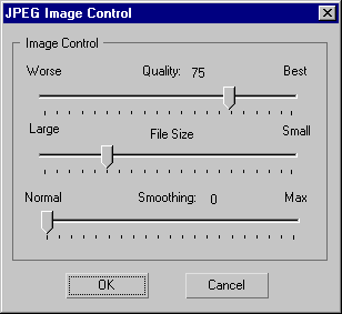

Interface
When JPEG is the chosen output format, clicking Render or Setup in the Render Output File dialog displays the JPEG Image Control dialog.
Quality
Move the slider to the level of quality you want: the higher the quality, the larger the file size. In general, files compressed with the slider set to Best have compression ratios between 5:1 and 15:1.
File Size
Move the slider to the size of file you want: the larger the file, the higher the quality.
Smoothing
Move the slider to the level of smoothing you want: the higher the level of smoothing, the larger the file size.
