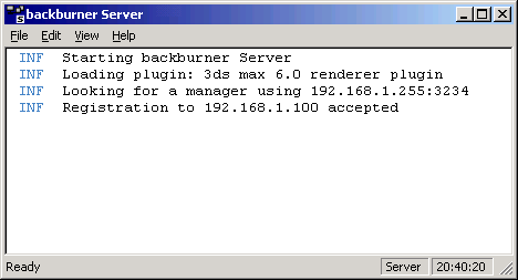

The application version of the network rendering Server provides a graphical user interface for control and monitoring purposes. It runs as a foreground process on your desktop, and remains active unless specifically shut down. Its components include a menu bar, list window, and status bar.
Once you initially set up the server using the application version, you can run it as a service from then on. The service version provides no user interface, but once it's installed as a service and started, it's always available when you boot the system. Whichever version you use, you can monitor and control the rendering queue and system with the Queue Monitor.

List Window
This area of the Server interface lists different types of information regarding the current status of Server. Depending on the selections made in the Logging Properties dialog, messages are displayed alerting the user, for example, to the following:
- Connection and registration between the Manager and Server(s)
- New job assignments
- Frames assigned/rendered
- Acknowledge packets sent between the Manager and Server(s)
- Manager/Server(s) shutting down
- Any rendering errors encountered
This information can be filtered using the Logging Properties dialog.
