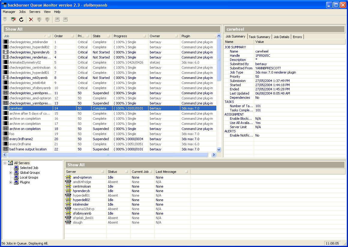

Interface
The Queue Monitor user interface comprises a menu bar, a toolbar, a status display, and four windows: job list, job information, server tree view (or hierarchical list), and server list.

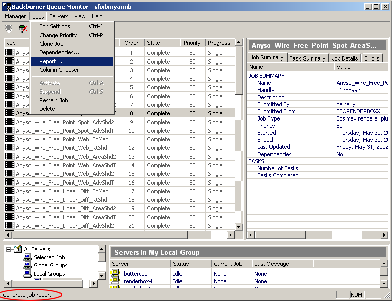

- Column Chooser
Opens the Job Columns dialog, with additional columns you can drag into the Job list title row. As you drag a column over the title row, arrows appear indicating where the column will be inserted.
To remove a column, right-click its title and then choose Remove This Column. You cannot remove the Job or Order column.

- Restart Job
Starts a job over at the first frame set in Job Settings.
- Archive Job
Archives a job currently stored in the queue. Archived jobs are removed from the Job queue and stored in the Job Archives.
- Job Archives
Accesses the Job Archives where jobs are stored after clicking the Archive Jobs command or if they're assigned to automatically archive upon completion. Choosing this command opens the Job Archive dialog where you can choose to Delete, Activate or Refresh jobs.
- Delete
Removes the highlighted job or jobs from the queue.

Job List
The Job List window lists all current jobs, along with progress and status. Additionally, a status icon before each job's name provides a graphical indication of its status. See Viewing Jobs and Servers with the Queue Monitor.
Right-click a job name to access the Jobs menu.
Click a column title to sort the list by the column contents (alternating clicks sort in ascending and descending order). Right-click a column title to access a menu that lets you sort the column, specify its alignment, remove the column (if it's optional), access the Column Chooser for adding optional columns, and display only the default columns.
Job Information Window
The Job Information window contains tabs for viewing information about different aspects of a single highlighted job in the Job List window. If no job is highlighted or multiple jobs are highlighted, this window is blank.

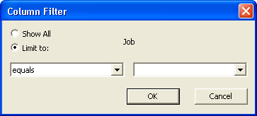

You can sort and filter columns in the Job Information Window. Click
in the column you wish to filter and select the Column Filter options.

Server Tree View
This window presents a hierarchical list of all Server groups, lets you create, delete, and rename global and local Server groups, and see which Servers can render your job.

Server List
The Server List window shows all Servers in the current group (selected in the Server Tree view). For each listed server, the windows displays, by default, its status, the job it's currently rendering (if any), and the last message it sent to the Manager. Additional, optional details can be shown using the Column Chooser command.
You can sort and filter columns in the Server List Window. Click in the column you wish to filter and select the Column Filter options.
