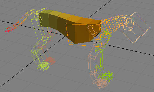

Spines are used in CAT to connect two hubs together. Spines provide special features that speed up your workflow, enable sharing of animation data among a diverse range of rigs, and allow sophisticated IK tools.
  • Select or add a hub object > Modify panel > Hub Setup rollout > Add Spine
Procedure
To create a spine:
  1. Select a hub to which to attach the spine.
  2. Do either of the following:
    • On the Modify panel Hub Setup rollout, click the Add Spine button.
    • In the viewport, right-click the hub and from the lower-left quadrant of the quad menu, choose Add Spine.
