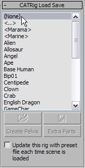

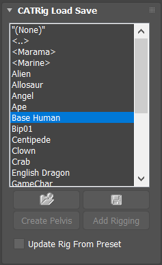

To load a CATRig preset:
  1. Open the Create panel and click (Helpers).
  2. Open the drop-down list at the top of the panel and choose CAT Objects.
  3. Click the CATParent button.
  4. Choose a preset rig from the list on the CATRig Load Save rollout.
  5. Click or drag in the viewport to add the preset to the scene.

  4. In the list on the CATRig Load Save rollout, make sure <None> is highlighted, and then drag in the Perspective or Top viewport to add the CATParent object.
  5. With the CATParent selected go to the Modify Panel.
  6. At the bottom of the CATRig Load Save rollout, click Create Pelvis.
