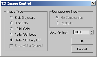

To open the TIF Image Control dialog, click Save or Setup on the Render Output File dialog.
Image Type group
Lets you choose the method for saving image information:
  • 8-bit Greyscale Creates an 8-bit grayscale image.
  • 8-bit Color Creates an 8-bit color image.
  • 16-bit Color Creates a 16-bit color image.
  • 16-bit SGI LogL Creates a color image that includes a logarithmic encoding of the luminance channel.
  • 32-bit SGI LogLUV Creates a color image that includes a logarithmic encoding of the luminance channel and UV color coordinate information.
Store Alpha Channel
When on, stores the alpha channel along with other image data. Alpha data adds 8 bits per pixel to the image type you selected.
Compression Type group
Lets you render a compressed TIFF file. Default=No Compression.
  • No Compression Does not compress the rendered image.
  • Packbits Uses the TIFF Packbits algorithm to compress the file.
Dots Per Inch
Sets the dots per inch (dpi) for the saved image. This setting does not change the resolution of the final image, but can affect the way it prints in documents.
