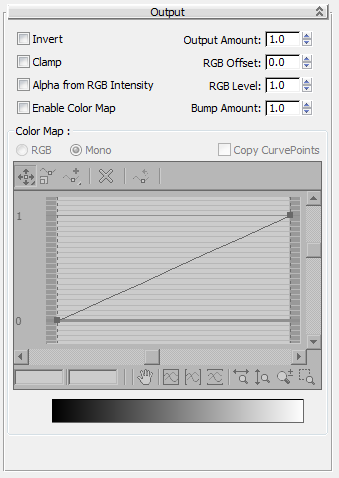

With Output map, you can apply output settings to procedural maps, such as Checker or Marble, that don't have these settings.
  • Material Editor > Material/Map Browser > Maps > General > Output
Interface
Output Parameters rollout
In this rollout, you choose the map to apply the output controls to.
Map
Displays a modal version of the Material/Map Browser so you can choose the map type.
The checkbox turns the map on or off.
Output rollout
The controls in this rollout are the same as for maps with a built-in output option. See Output Rollout.
