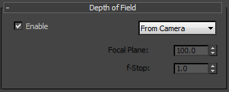

- Enable
When on, the rendering generates depth of field. Default=off.
- [Camera drop-down list]
When From Camera (the default) is chosen, the Quicksilver renderer uses the camera's Target Distance and f-Stop settings to generate depth of field.
When Override Camera is chosen, you can choose values for generating depth of field that differ from the Camera settings.
- Focal Plane Sets the location of the focal plane as a distance from the Camera object, in 3ds Max units. Default=100.0.
- f-Stop Sets the f-Stop value to use in conjunction with the Focal Plane. Increasing the f-Stop value broadens the depth of field (increasing the focal range), and decreasing the f-Stop value narrows the depth of field (decreasing the focal range). Default=1.0.
