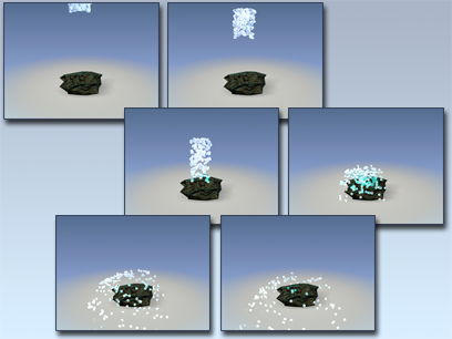

Particles scatter when they strike a UDeflector object
