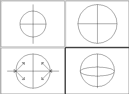

SOmniFlect is the spherical version of the omniflector type of space warp. It provides more options than the original SDeflector. Most settings are the same as those in POmniFlect. The difference is that this space warp provides a spherical deflection surface rather than the planar surface. The only settings that are different are in the Display Icon area, in which you set the Radius, instead of the Width and Height.

SOmniFlect viewport icon

  2. Drag in a viewport to create the spherical icon.
    Note: Because particles bounce off the icon, the size of the icon affects particle deflection.
