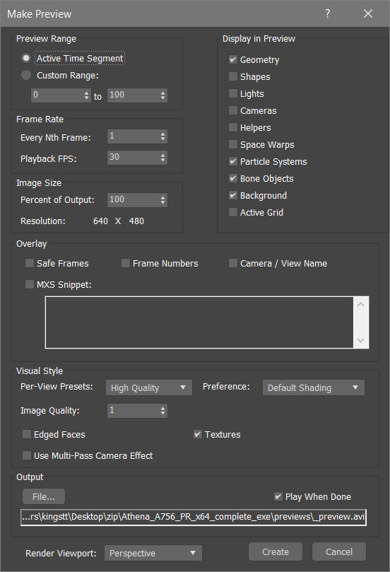

Preview Range group
Active Time Segment
Includes only the active time segment in the preview.
Custom Range
Includes only the frames specified in the range in the preview.
Frame Rate group
Every Nth Frame
Provides a regular sampling by including only every Nth frame (number you specify) in the preview.
Playback FPS
Specifies the playback frame rate in frames per second.
Image Size group
Sets the resolution of your preview as a percentage of the current output resolution. You set the output resolution on the Render Setup dialog. For example, if the rendering output resolution is 640x480, and you set Percent Of Output to 50, the preview resolution is 320x240.
Note: The size of the preview image is limited by the size of the viewpanel region (the region that contains the viewports). The setting is clamped to the maximum value that allows the preview image to fit in the viewpanel region.
Display in Preview group
Specifies what is displayed in the preview. Options include:
  • Geometry
  • Shapes
  • Lights
  • Cameras
  • Helpers
  • Space Warps
  • Particle Systems
  • Bone Objects
  • Background
  • Active Grid.
Display in Preview group (Legacy viewports)
For legacy viewports (Direct3D or OpenGL), specifies the types of objects to include in the preview. Frame Numbers prints a frame number in the upper-left corner of each frame of the AVI file. Background includes the assigned viewport background in the preview.
Overlay group
Specifies additional information to be overlaid on top of the preview frames. Options include:
  • Safe frames
  • Frame numbers
  • Camera/View Name
  • MXS Snippet
It is not possible to change the appearance (color, font size, etc.) of the overlaid output.
The MXS Snippet is MAXScript code that is executed for every frame of the preview, the output of which is overlaid on each rendered frame. For example, this statement adds a copyright statement and the current frame number:
print("(c)Example " + sliderTime as String)
There are no restrictions on the MAXScript that can be executed, but it should be limited to accessing frame and scene information for performance reasons.
Visual Style group (Nitrous viewports)
Per-View Presets
Options include High Quality, Standard, Performance, or DX Mode.
Preference
Sets how objects are rendered. Options include:
  • Default Shading
  • Wireframe
  • Clay
  • Facets
  • Bounding Box
  • Hidden Line
  • Flat Color
  • Model Assist
  • Graphite
  • Color Pencil
  • Ink
  • Color Ink
  • Acrylic
  • Pastel
  • Tech
Edged Faces
Includes face edges in the preview.
Use Multi-Pass Camera Effect
Includes the effect of having multiple camera passes in the preview.
Textures
Includes textures in the preview.
Rendering Level group (Legacy viewports)
[Rendering Level drop-down list]
For legacy viewports (Direct3D or OpenGL), specifies the viewport rendering method to use in the preview.
Output group
Play When Done
When the preview is created, opens the Media Player and automatically plays the preview.

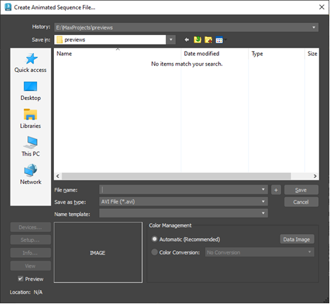

File
Opens the Create Animated Sequence File dialog.
File name
Specify the file name. If you want a specific format, select it from the Name template list first.
Save as type
Specify the type of file to save. This list also serves as a filter.
Name template
Lets you choose a file name based on the 3ds Max scene and system settings, where:
  • <scene> is the root name of the MAX scene file
  • <camera/view> is the name of the active camera or viewport
  • <mm> is the month
  • <dd> is the day
  • <yyyy> is the year.
The text field lets you create new templates. Any text you enter becomes part of the name template. Up to 10 custom templates can be saved in addition to the default templates. Once the maximum number of templates has been saved, entering a new template causes the first custom template to drop off the list.
Devices
Lets you choose from the hardware output device; for example, a digital video recorder. The device, its driver, and its 3ds Max plug-in must all be installed on your system.
Setup
Displays controls for the selected file type. These vary with each different file format. Change the settings as necessary.
Info
Displays expanded information about a highlighted file such as frame rate, compression quality, file size, and resolution. The information here depends on the type of information saved with the file type.
View
Displays a highlighted file at its actual resolution. If the file is a movie, the Media Player opens.
Color Management [OCIO color management modes only]
Controls how colors are converted from the rendering space when saving output files.

Preview
Displays a thumbnail of the selected file.
Location
Displays the full file path.
Render Viewport
This list shows the names of the currently visible viewports, letting you choose which viewport to render from within the Make Preview dialog.
Create
Creates the animation preview.
