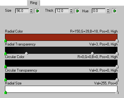

The ring is a circular color band that surrounds the center of the source object. You set ring options on the Ring panel of the Lens Effects Flare dialog.
  • Rendering menu > Video Post > Video Post toolbar > (Add Image Filter Event) > Choose Lens Effects Flare from Filter Plug-In list. > Setup > Ring tab
Interface
Size
Specifies the overall size of the ring as a percentage of the overall frame and represents the diameter of the ring. The ring radius should be larger than the glow radius to make the lens flare look convincing. This parameter is separate from the overall size spinner in the Lens Flare Effects section of the dialog. This parameter can be animated.
Thick
Specifies the overall thickness of the ring, as a percentage of the overall size of the frame. When the ring is fairly thick, the size of the ring is measured to the inner radius. The thickness controls how thick the ring is from that point outward. This parameter can be animated.
Hue
Specifies the gradation of color for the ring. This parameter can be animated.
Gradients
Use radial, circular, transparency, and size gradients.
