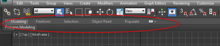

The ribbon can assume a horizontal or vertical orientation when docked, or a vertical orientation when floating. It can be maximized (Show Full Ribbon) or minimized to tabs, panel titles, or panel buttons. By default, the ribbon is horizontal, minimized to panel titles, and is docked just below the main toolbar, as shown in the following illustration (red outline added for emphasis).

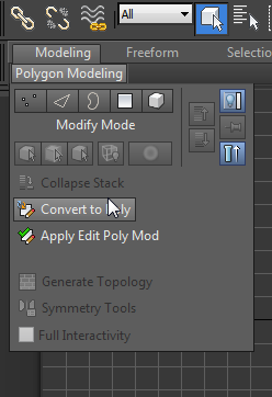

To convert an object to editable poly or Edit Poly format:
    For most ribbon functions on the Modeling, Freeform, and Selection tabs to be available, a single editable poly or Edit Poly object must be selected, and the corresponding stack level must be active. If the object you want to work with is not in the required format, you can use the ribbon to convert it.
  1. Select an object.
  2. If the ribbon is minimized, open the Polygon Modeling panel; otherwise, open the panel expansion.
  3. Choose Convert To Poly or Apply Edit Poly Mod.
    This converts the object or applies the modifier, respectively, and switches to Modify mode if necessary.
