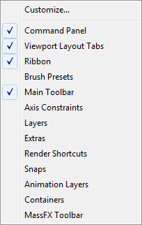

The Customize Display right-click menu displays when you right-click over a blank area of a toolbar (not when the cursor is over a button) or certain parts of the command panel. Use this menu to toggle the display of various user-interface elements, customize the display of toolbars, and dock or float items such as the command panel.
Right-click a blank area of a toolbar to open the Customize Display right-click menu.

The following options always appear on the menu:
Customize
Opens the Customize User Interface dialog, which lets you edit keyboard shortcuts, toolbars, and more.
Command Panel
Toggles the Command panel. Default=on.
Viewport Layout Tabs
Toggles the Viewport Layouts tabs bar. Default=on.
Ribbon
Toggles the Ribbon. Default=on.
Brush Presets
Toggles the Brush Presets toolbar. Default=off.
Main Toolbar
Toggles the main toolbar. Default=on.
Axis Constraints
Toggles the Axis Constraints toolbar. Default=off.
Layers
Toggles the Layers toolbar. Default=off.
Extras
Toggles the Extras toolbar. Default=off.
Render Shortcuts
Toggles the Render Shortcuts toolbar. Default=off.
Snaps
Toggles the Snaps toolbar. Default=off.
Animation Layers
Toggles the Animation Layers toolbar. Default=off.
Containers
Toogles the Container toolbar. Default=off.
MassFX Toolbar
Toggles the MassFX toolbar. Default=off.
