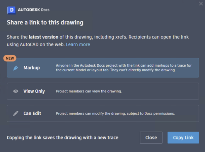

To Share a drawing for markups
- Click . Find
- In the Share dialog, select Markup.
- Click Copy Link. This creates a new trace of the current Model or layout tab and saves the drawing.
Share the URL with any collaborators who have access to the Autodesk Docs project.
