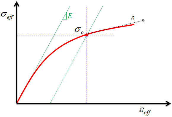

The response of the matrix constituent material is provided by a Ramberg-Osgood plasticity model [13] that has been enhanced to allow the predicted plastic response to exhibit sensitivity to the direction of the loading relative to the fiber direction. The effective hardened yield strength of the matrix constituent material can be expressed as
eq1
where σ0 and n are the typical material parameters used by the standard (isotropic) Ramberg-Osgood plasticity model, and εp,eff is the effective plastic strain in the matrix constituent material. The yield function is satisfied when the effective stress in the matrix constituent matches the hardened yield strength.

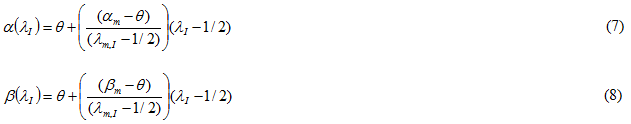

It should be emphasized that the material only exhibits strong directional dependency when the degree of fiber alignedness is relatively high. When the fibers are randomly oriented, the plasticity response must revert to an isotropic response. To accommodate these behavioral characteristics, the directionally dependent weighting coefficients (α, β) cannot be constants. Rather, they must be functions of the degree of fiber alignedness. In the present model, α and β are assumed to be linear functions of the degree of fiber alignedness which is quantified by the largest eigenvalue λI of the fiber orientation tensor.
eq7
In Eqs. 7 and 8, αm and βm are the values of α and β respectively that are optimized to fit the response characteristics of a strongly aligned material that has a largest fiber orientation eigenvalue of λm,I. θ is the value that both α and β should achieve when the fiber orientation becomes random. Note that λI ranges from 1.0 for a perfectly aligned material to 1/3 for a material with completely random fiber orientation in all three directions (a completely isotropic condition).
However, the condition of a truly 3-D random distribution of fibers is not likely to occur for thin injection molded parts. It is much more likely that a thin injection molded part might contain some locations that exhibit random fiber orientation in the plane of the injection molded part, but not in the part's thickness direction (i.e., λI = 1/2). In order to accommodate this more common form of isotropy, Eqs. 7 and 8 contain the coefficient (λI - 1/2) which ensures that when λI = 1/2, α and β each achieve the same value of θ, and thus the material becomes isotropic.
ro plot
