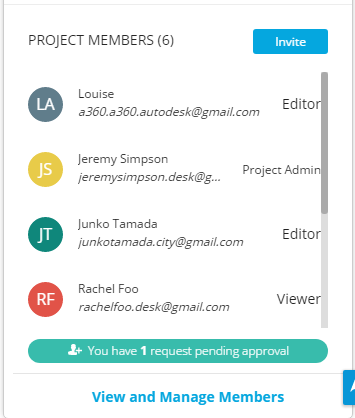

To manage project members
- Open the project.
- Click View and Manage members in the Project Members area.
- To invite people, click Invite > enter email address > Send Invitations.
- To remove a project member, click Delete.
To manage requests to join projects
Team Members on the hub can request to join Closed projects. Requests are shown in Alerts as well as the Project Members area.
To manage requests from Alerts, click Alerts > Approve or Reject.
To manage requests from within the Project:
- Open the project.
- Click the pending approval notification in the Project Members area.
- Click Approve or Reject for each join request.
