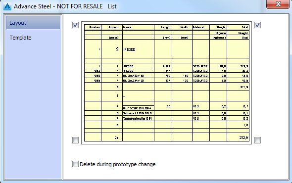

The Layout Tab
On this tab of the properties dialog box, you can define the fixed points of the list. Each checkbox corresponds to a corner of the frame of the list. Selecting two check boxes on a side prevents the list from extending on that side.
The Delete during prototype change check box Controls the list behavior during the prototype change. If checked, the list is deleted.

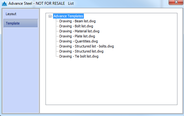

The Template Tab
This tab lists all available templates. By default, the templates are installed in ...\ProgramData\Autodesk\Advance Steel 2025\[INSTALLATION LANGUAGE EXTENSION]\Shared\Support\BOMTemplates\.
