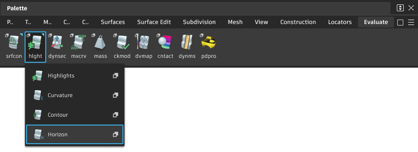

Access this tool from the Evaluate palette:
