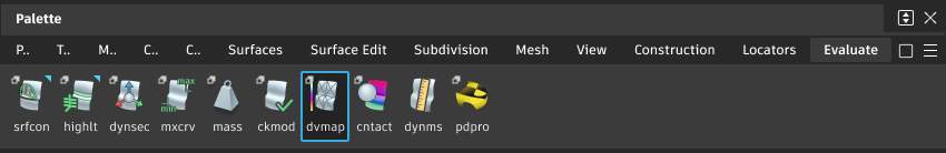

Access this tool from the Evaluate palette:

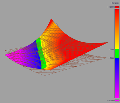

Deviation Map workflows
You can show a colored error map of the deviation (distance) between a set of meshes and a set of NURBS surfaces, or between two sets of meshes, or between two sets of NURBS surfaces.

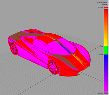

Display a Mesh-to-Surface deviation error map
Select one or more surfaces, then click the Accept button.
Select one or more meshes, then click the Go button.
The deviation error map appears on the surfaces and a color ramp (deviation ramp) is displayed.

The color in the center of the ramp (green) identifies regions where the deviation is within an Acceptable Distance value. The colors at both ends of the ramp identify regions where the deviation is above a certain maximum value (Ramp Distance) in either direction. Between these two values, the surface displays intermediate colors as shown on the ramp. The color distribution on the ramp can be adjusted as follows:
Double-click the tool to open the option box.
Use the Acceptable Distance and Ramp Distance sliders to modify the tolerance bands in the color scale.
The deviation error map on the surface(s) updates.
Note: The Ramp Distance is the maximum distance between surface and mesh shown on the color ramp. It should be kept larger than the Acceptable Distance.Turn on the Absolute Value Ramp option if you are not concerned about the direction of the deviation and only want to see absolute deviation values.
Turn on the Use Bands option if you want the ramp to display solid bands of color instead of slowly varying colors.
