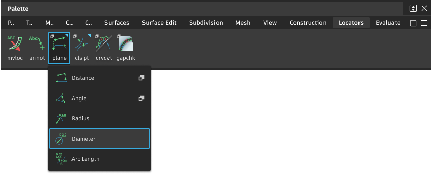

Adds a radius or diameter measurement to a curve.
Access this tool from the Locators palette:
