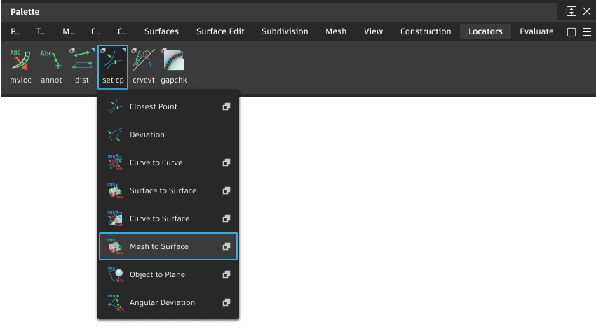

Mesh to Surface
Adds a measurement showing the minimum and maximum deviation between a mesh and a surface. This tool creates a locator showing the deviation between the two objects, labeling the minimum and maximum.
Objects in reference layers can be selected from within this tool.
Access this tool from the Locators palette:
