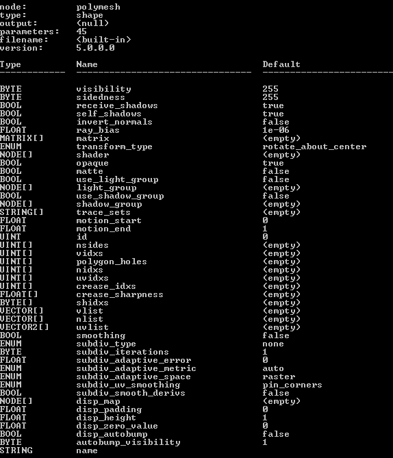

You can query the list of parameters an Arnold core node has by using kick. For example, you can get the attribute names of a polymesh node by using:
kick -info polymesh
Info: Always refer to the core Arnold nodes (the nodes you see if you export an ass file and open it in a text editor), and not to the parameter's name as exposed in the Arnold plugin.
If you want to set multiple Arnold parameters in a User Options string, you can use any whitespace (spaces, tabs, newlines e.g., \n) that you would use in an actual ASS file.
kick -info polymesh parameters available through kick
