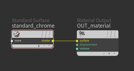

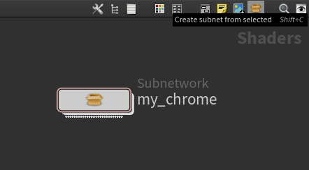

Create a Subnetwork
  • Create an Arnold vopnet containing your desired shader network.

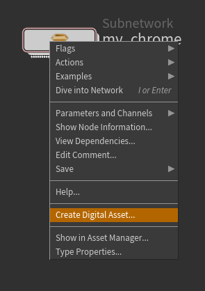

  • At shop level click the Create Subnet... box.
Create Digital Asset

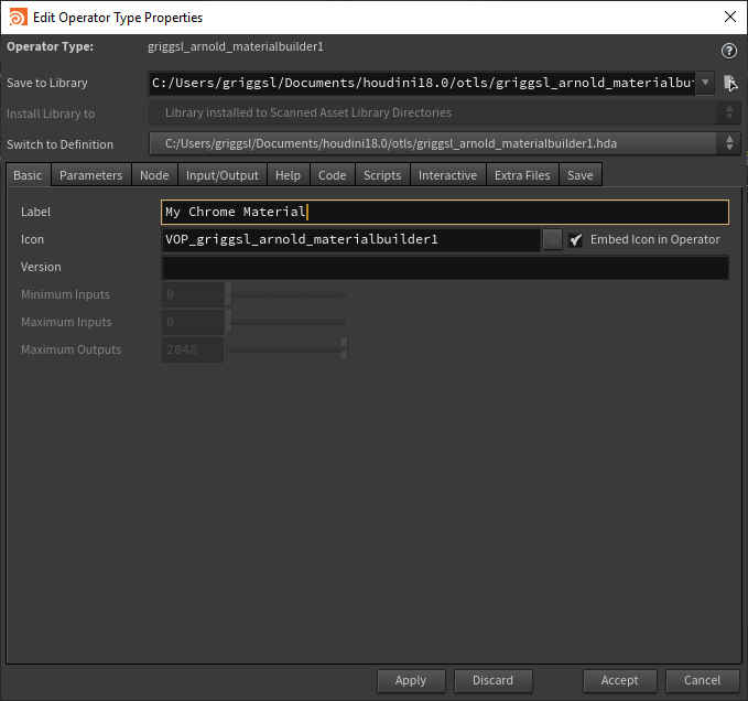

  • Right-click on the material1 subnet -> Create Digital Asset

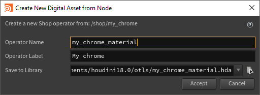

  • Enter the Name, Label and choose the otl library to save to. Edit Operator Type Properties pops up.

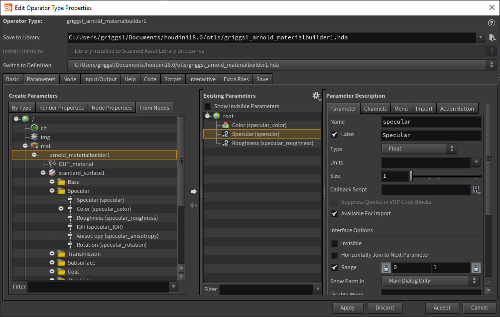

In the Basic tab, set Editable Nodes and Dive Target to the arnold vopnet, in this case, called my_ chrome.
In Parameters > From Nodes, drag and drop the parameters of the subnet you want to expose in your material asset on the Existing Parameters panel.

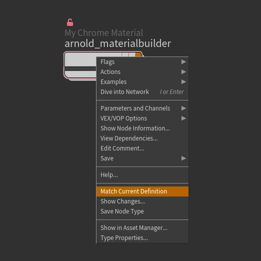

Updating the Digital Asset

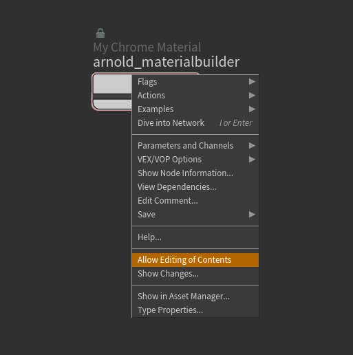

Right-click on the digital asset > Match Current Definition to update the node with these changes.
To alter the node again, right-click > Allow Editing of Contents.

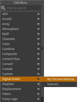

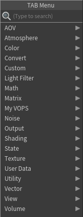

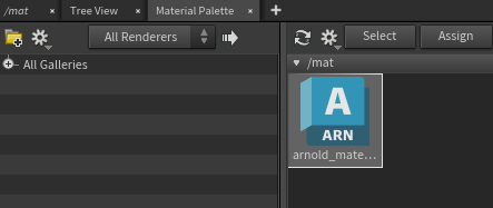

Changing The Tab-Menu
The asset will now be listed in the tab-menu. By default, it will be under Digital Assets and Materials.

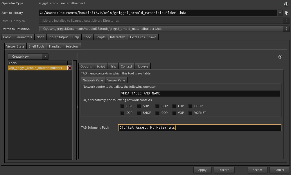

This can be changed by right-clicking on the node > Type Properties. Under the Tools Tab > Context Tab the Tab Submenu Path can be altered.
