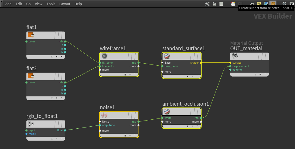

A subnetwork can either be created from scratch or from a pre-existing shader network using the create subnet from selected button. You will need to know which parameters are going to be exposed. To parameterize selected inputs, add connections that won't be included in the subnet selection.

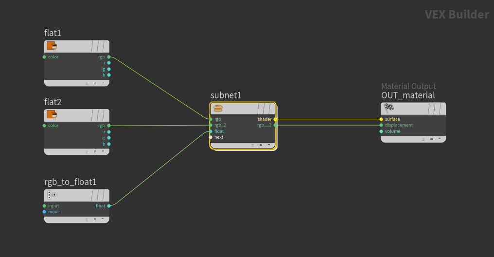

Selecting the nodes and clicking the subnet icon
A subnet has been created

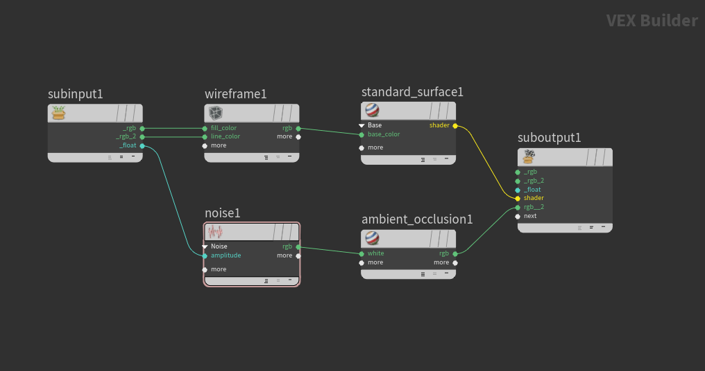

The nodes inside the subnet

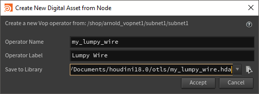

From the subnet, a digital asset can be created. Right-click on the subnet and choose Create Digital Asset, which brings up the Create New Asset from Node dialogue.
The HDA must be given a unique Operator Name. It must not have the same name as any other operator in Houdini, as it will override it. For safety, it is a good idea to prefix the HDA with your username, show, or shot depending on its use.
An OTL is a library of HDAs. The HDA can be added to a pre-existing library although unless it is going to be part of a sophisticated pipeline that requires otherwise it is recommended to save one HDA per OTL with the OTL given the same name as the HDA. The OTL will be saved in/home/user/houdini/otls unless specified otherwise.
Clicking Accept will save the OTL file and bring up the Edit Operator Type Properties box. This will be discussed more in the next section.

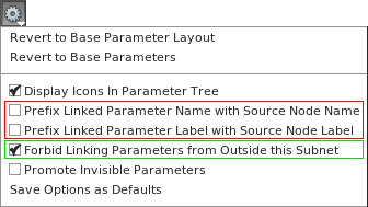

Before adding any parameters, it's advisable to make sure the Prefix Linked... options are unchecked in the options and Forbid Linking... is turned on.

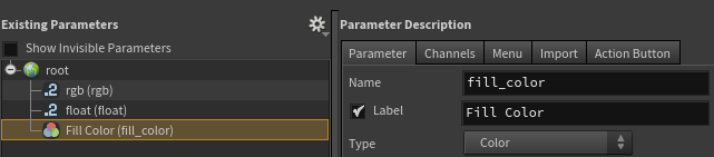

Choosing a parameter in the Existing Parameters column allows the names to be changed. Name is the internal Houdini token, whilst Label is the nice name for the interface. The parameter Type can be changed, for example, from Float to Color. It is also possible to add range limits and interface options.
Default parameter names and types
Parameter names and types changed

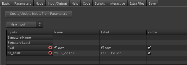

Matching Inputs
It is important that the input has the same name as the corresponding parameter. Choose "Create/Update Inputs From Parameters" from the Input/Output tab. This will add the updated names as Inputs. Delete the old inputs using the cross.

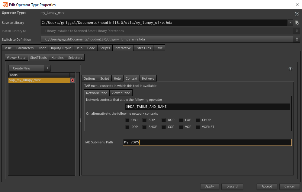

Changing Tab Submenu
The Tab submenu can be changed in the Shelf Tools Tab > Context Tab; and then change " Digital Assets " in the *Tab Submenu Path.
