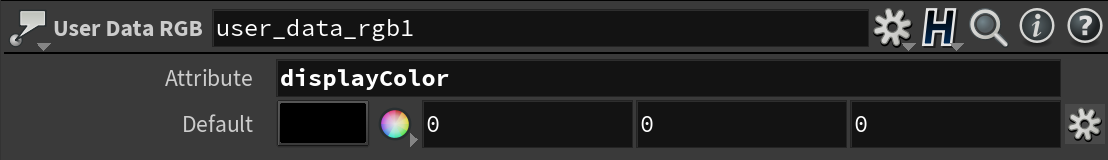

See stage/materiallibrary1/arnold_materialbuilder1/user_data_rgb1 on how to access Cd.

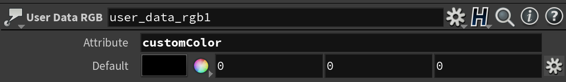

See stage/materiallibrary2/arnold_materialbuilder1/user_data_rgb1 on how to access customColor.

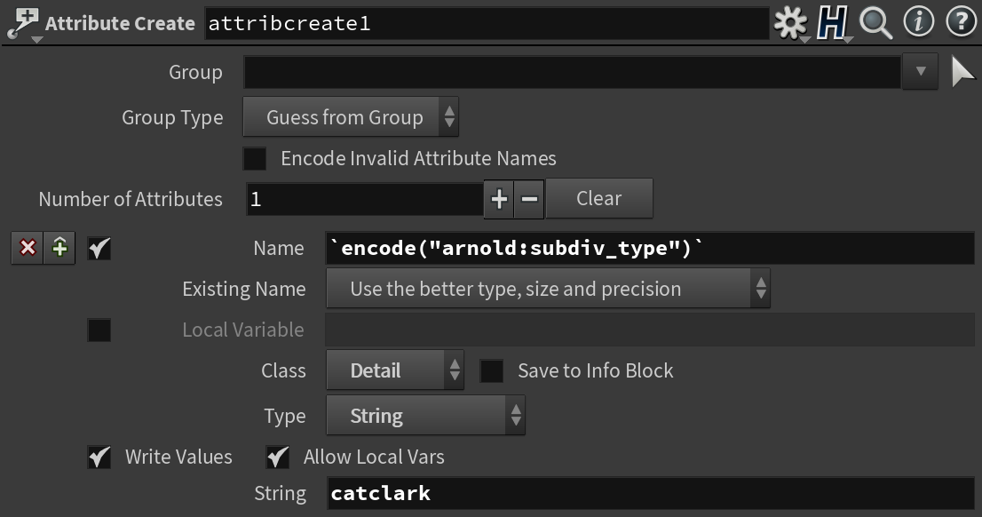

See stage/sopcreate1/sopnet/create/attributecreate1 to set subdiv_type on the prim:

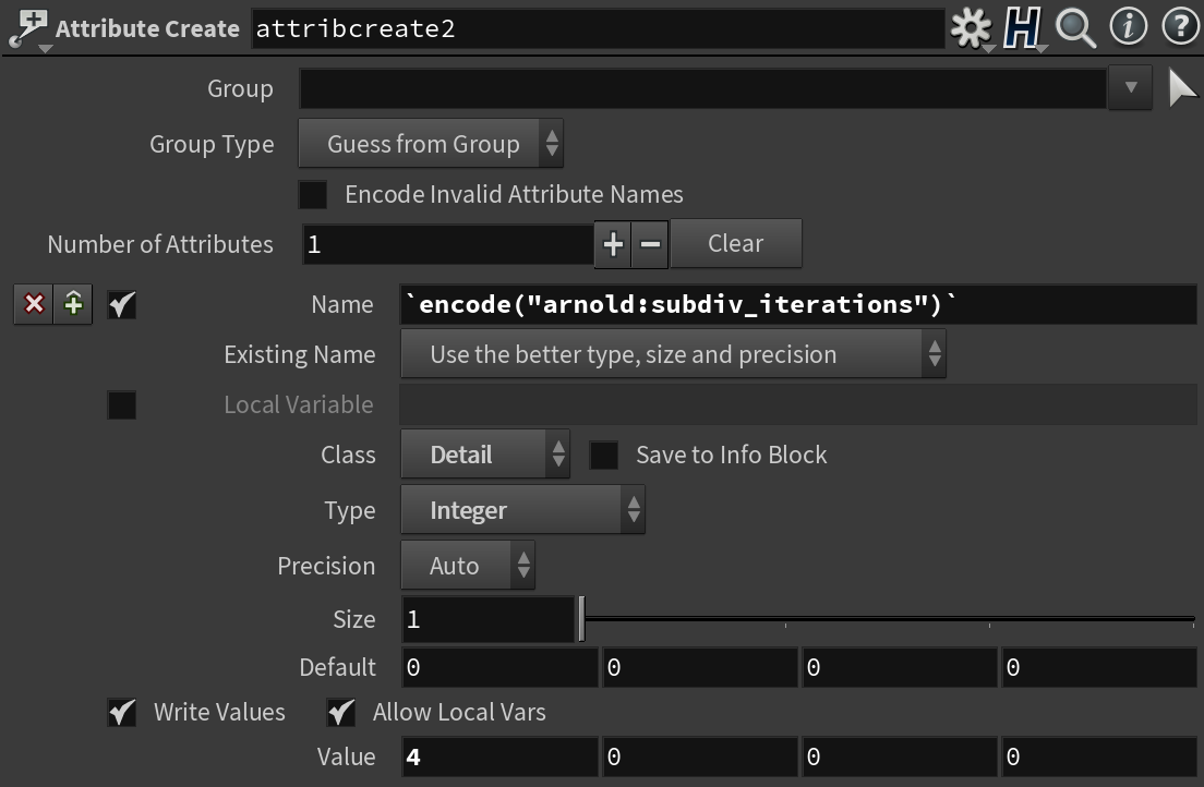

See stage/sopcreate1/sopnet/create/attribcreate2 to set subdiv_iterations on the prim:

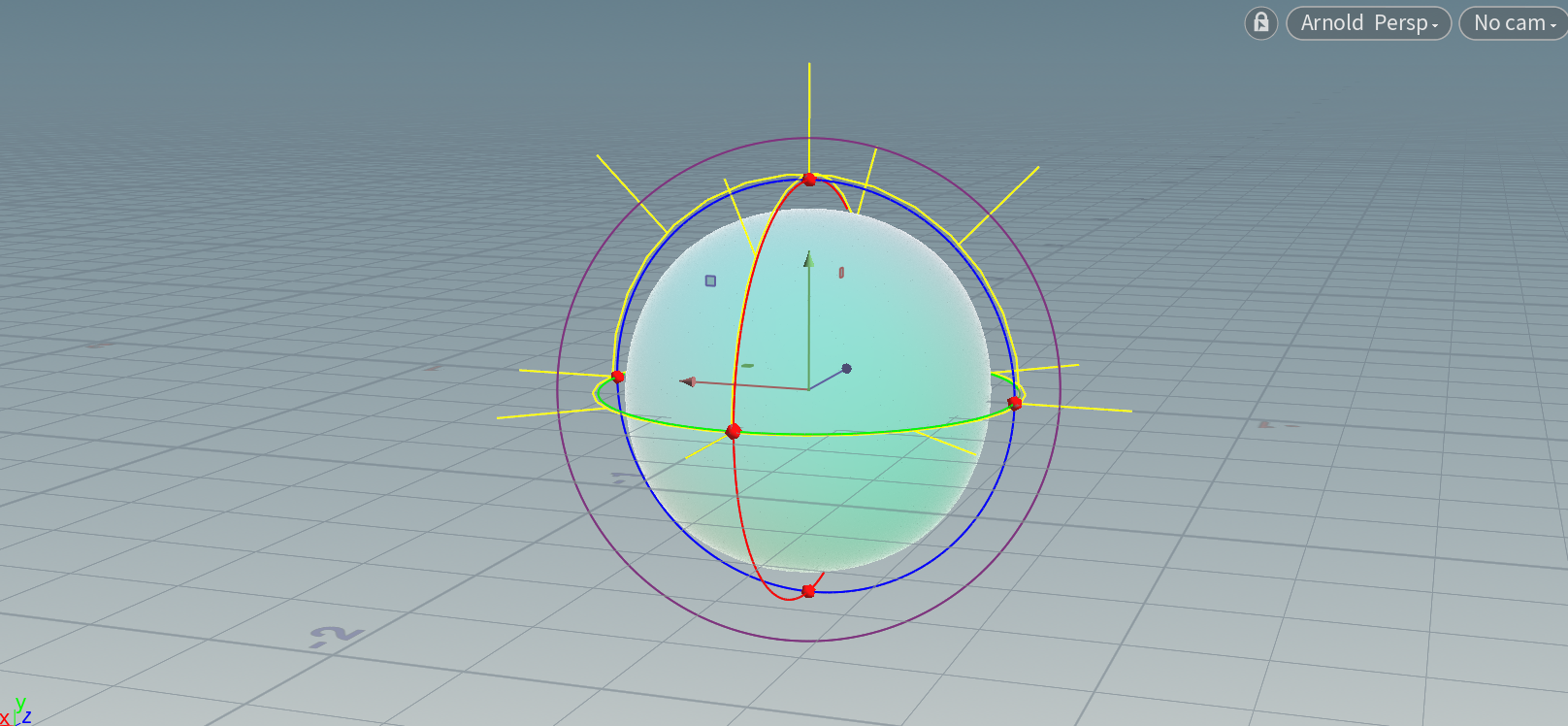

When viewing the object in stage, it'll be subdivided using a 4 iteration catmull-clark subdivision:
