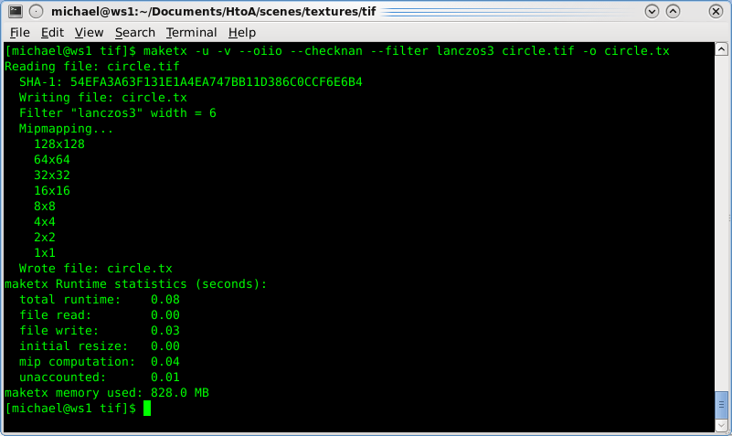

The maketx command with verbosity, converting from a tif to a tx

maketx [options] file... eg: maketx -v -u --oiio --checknan --filter lanczos3 path/to/fileIn.tif -o path/to/fileOut.tx
When pre-processing your texture files with maketx make sure you add the -- oiio flag, which will generate TX files optimized for Arnold that can render even faster by forcing the tile size to be optimal for OpenImageIO ( 64x64). It also stores channels interleaved (RGBARGBA...), making them faster to read and enabling constant color detection: if the image is a constant color, it will convert it to a tiny single color .tx file. Additional metadata and an image hash (fingerprint) are embedded by default. The fingerprint lets OIIO detect duplicate images (not tiles) when opening new files. Generally, using maketx will result in better texture I/O performance than using txmake.
Note also that if you need your textures to stay compatible with Renderman, there is a --prman switch that will ensure the tile size matches what Renderman expects.
If the output color space is not the same bit depth as the input color space, then the data format needs to be set to the proper bit depth using the -d option.
The best workflow is to always generate .tx files using maketx as the last step before rendering, and use those .tx files just for rendering. This will ensure the best performance. Also, ensure that your textures are in linear color space before converting them with maketx. No information is lost when converting High Dynamic Range images to the .tx format.
