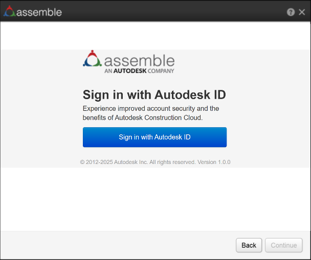

    • The Assemble Sign in dialog appears.
    • img
  5. Sign in to Assemble.
    To sign in to Assemble:
    • Note: You will use your Autodesk ID to sign in.
    1. Click Sign in with Autodesk ID button in the center of the dialog. The Sign In dialog will appear.
    2. In Email, enter your email address and click Next. A Welcome dialog will appear.
    3. In Password, enter your Autodesk ID password and click Sign In.

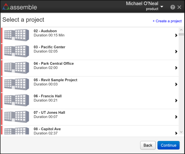

      Autodesk Assemble will open to the Select a project page.
