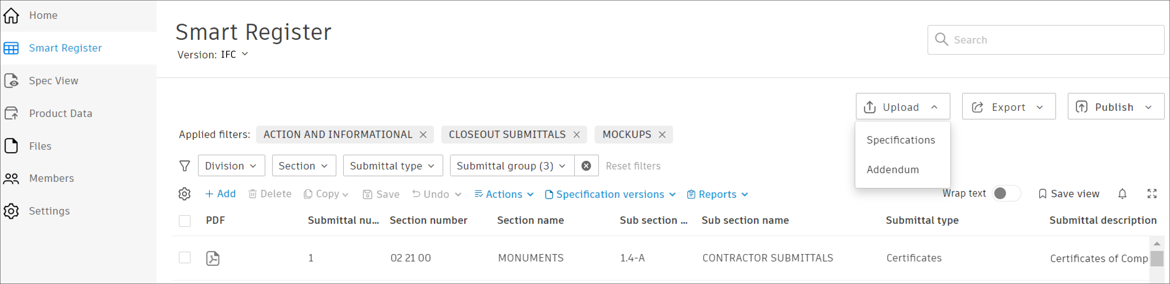

To upload a specification:
Navigate to the Smart Register tool.
Click Upload and choose Specifications.
Note: You can also upload a Specification from the Homepage.

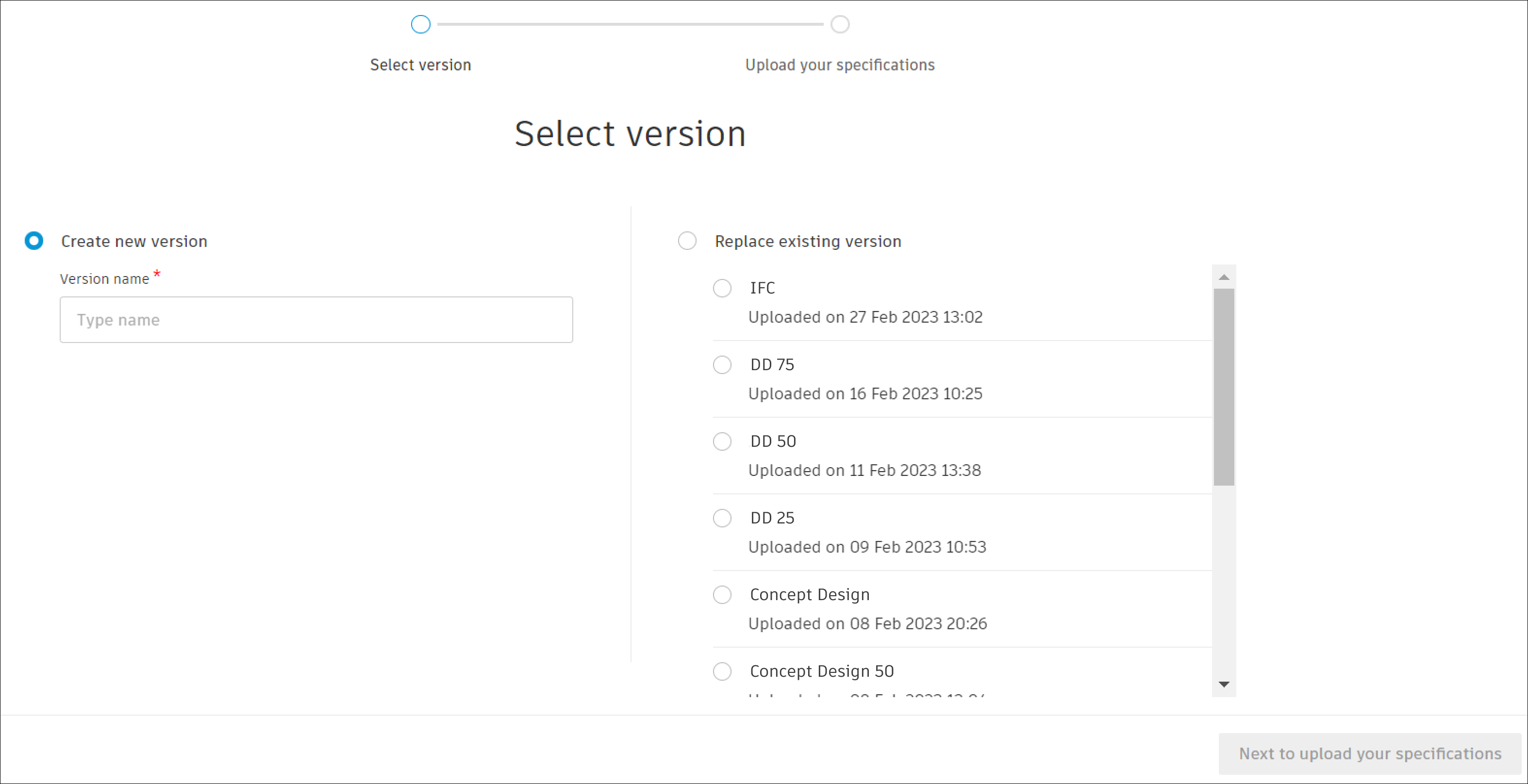

On the next screen, choose to Create a new version or Replace an existing version. If you create a new version, provide a unique version name.
Click Next to upload your specifications.

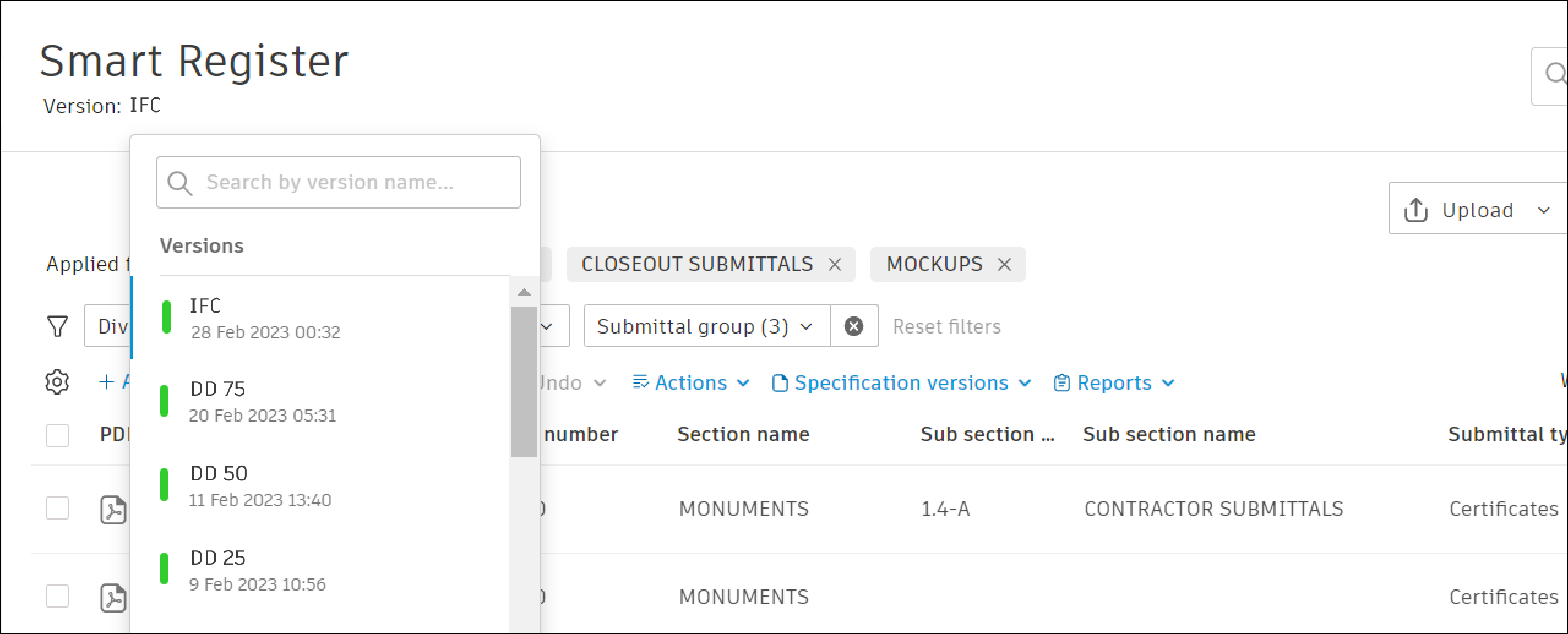

Specification Versions
AutoSpecs supports multiple versions of specifications and addendums.
To create a new specification version, follow the steps outlined at the top of the page for uploading a specification and choose to Create a new version.
Once you've uploaded multiple versions of a specification, you can quickly switch between versions in the Smart Register tool. Click the Version drop-down to select the version you'd like to view.

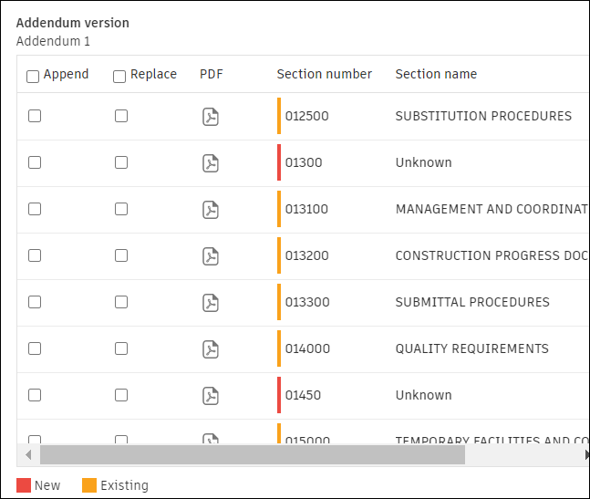

Click Next to append and replace.
When your results are generated, decide what action to take for each identified specification section.
Choose Append for every specification section for which you'd like to add the information contained within the addendum as a brand new specification section to your register.
Choose Replace for every specification section for which you'd like to overwrite the information in your current Smart Register with the updated information from your addendum.
Click Append and replace once you've selected the appropriate action for all identified specification sections you'd like to add to your register from your addendum and confirm the selection.
Note:Don't choose specification sections that you don't want to append or replace.
Click View Smart Register to see the updates.

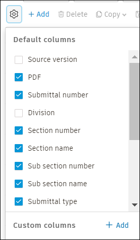

The submittal register will be updated within a few moments. Search the addendum name in the search bar or reveal the Source Version column to see and search all addenda uploaded to the current version of your project.

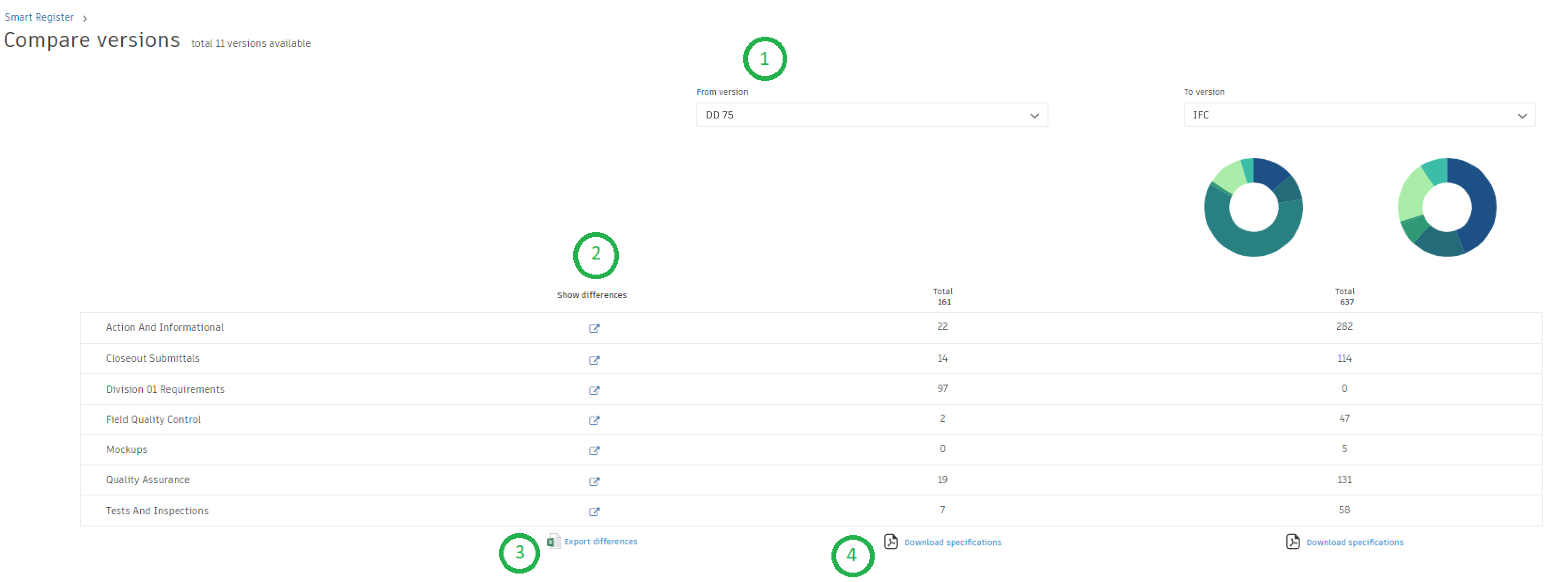

Use the version comparison feature to quickly see all differences between specification versions.

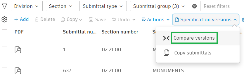

From the Smart Register tool, click the Specification versions drop-down menu and choose Compare versions. This will bring you to a comparison overview page.
From this screen, you can select which versions to compare, export version differences, and open up a detailed comparison of individual sections.
- Select which versions of your specification to compare.
- Click each icon to open up a detailed comparison.
- Export a spreadsheet of comparisons.
- Download specification PDFs.
When you open up a detailed comparison, changes between the two specification versions are shown in the form of what was added, deleted, modified, or unchanged.
- Added appears in green and shows a new requirement added to the version.
- Deleted appears in red and shown what was removed.
- Modified appears in yellow and shows what was changed from one version to the other.
- Unchanged has no color coding and means that the requirement wasn't changed between versions.
