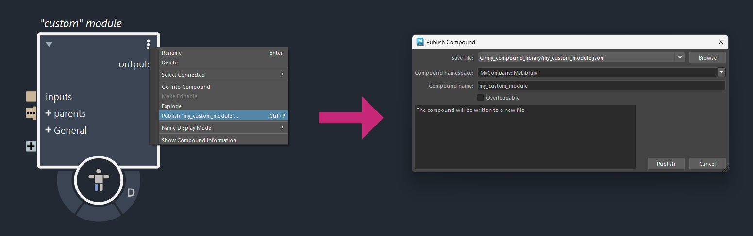

When your module is ready, you can publish it. To publish a module:
- Click on the three dots at the top of your module and select Publish "my_custom_module"....
- Use the Browse button to set the file path.
- Define the name and namespace of your module.
- Click on Publish to complete the process.
Once published, the module can be created via the Tab menu or the Node Library, and its JSON file can be distributed.
