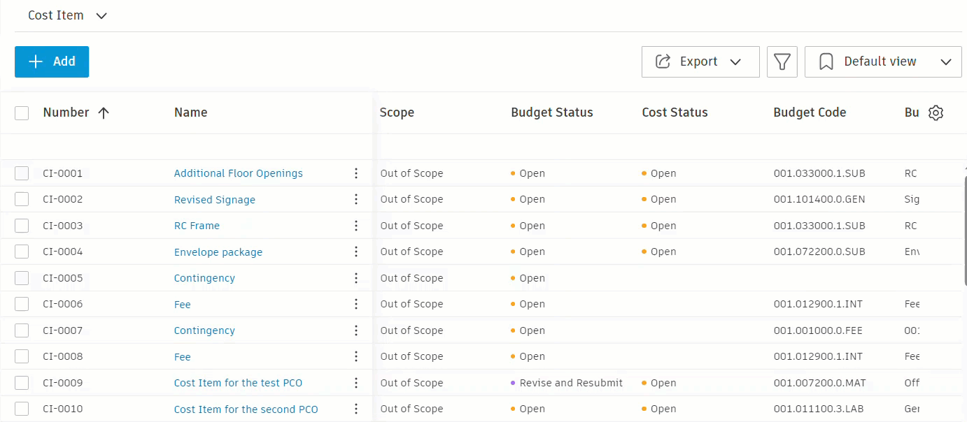

Add a Cost Item
Cost items can be added in the Cost Item tab:
  1. Click Add on the Cost Item tab in Cost Management.
  2. Enter a name for the cost item.
  3. Select a Budget Code from the drop-down list.
  4. Enter an estimated price.
  5. Select a Location for the cost item from the location breakdown structure. You can also copy a location of a cost item.
  6. Select the checkbox next to the cost item.
  7. Click Assign.
  8. Select a PCO from the PCO drop-down list.
Tip: After cost items are added, you can edit the items by clicking the budget item and using the panel on the right. You can make these edits from both the Cost Item tab and the PCO tab.

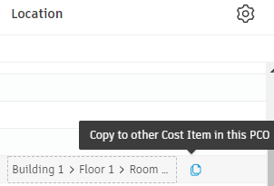

Copy a Location of a Cost Item
If a location for one cost item applies to other cost items within the same PCO, you can copy the location. To do so:
  1. From the PCO tab, hover your cursor over the Location field of the cost item assigned to a PCO.
  2. Click to copy the location to the other cost items in the PCO.

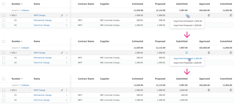

Copy a Cost Item's Amount
You can copy all cost items' amounts of the same change order to the current column:
  1. Click next to the cost item in the Estimated, Proposed, Submitted, Approved, or Committed column.
  2. Choose one of the available values to copy from.
Tip: You can copy values in the Change Order table, the Cost Item table, and when generating a change order or contract.

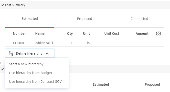

Add a Cost Subitem
Within individual cost items, you can add subitems that roll up into the parent cost item. You can define the:
  • Cost item hierarchy for each of the Estimated, Proposed, Submitted, Approved, and Committed tabs
  • Subitem hierarchy differently for each tab or inherit the subitem hierarchy from another tab
To add a cost subitem:
  1. Click a cost item name to open the details panel.
  2. Select a tab in the Cost Summary.
    Note: The tab you select determines which column in the table the subitem total appears in.
  3. Click the Define Hierarchy menu.
  4. Choose between:
    • Start a New Hierarchy - enter the Code, Name, Quantity, Unity, and Unit Cost for a subitem.
    • Use Hierarchy from Budget - this option is available when cost item is linked to a budget. Select the checkbox for SOV to use and then click Save.
    • Use Hierarchy from Contract SOV - select the checkbox for SOV to use and then click Save.
  5. Enter the code, name, quantity, unit, and unit cost for the subitem.

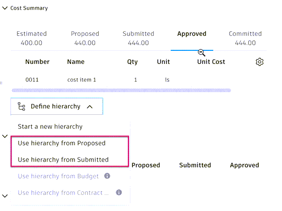

    Note: When an Estimated, Proposed, Submitted, Approved, or Committed value is already provided, you can use its hierarchy by selecting Use hierarchy from ..., for example Use hierarchy from Proposed.

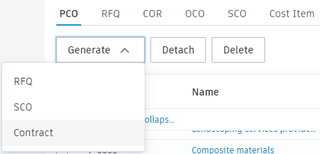

Generate a Change Order
You can generate an RFQ and SCO from a cost item. To do so, click the More menu next to the cost item, and then choose Generate RFQ or Generate SCO from the Generate category.
Generate a Contract from a Cost Item
You can generate a contract from a cost item when the cost item meets the following conditions:
  • The PCO status is one of the following: Open, Pricing, Proposed, Accepted, Revise and Resubmit.
  • The cost item is:
    • Not associated with an existing contract.
    • Not associated with an existing SCO.
    • In the same main contract.
  • The budget of the cost item isn't already allocated to a contract.
To generate a contract from a cost item:
  1. Click the Change Order tab.
  2. Switch to the PCO tab.
  3. Click the checkbox to the left of a cost item within a PCO.
  4. Click Generate, and then Contract.
    Tip: You can also click the More menu to the right of a cost item. Choose Generate, and then Contract.
