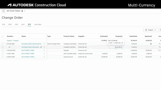

Foreign Currencies
With multicurrency functionality, foreign supplier management is streamlined. Teams can easily manage supplier contracts, change orders, payment applications, and expenses in different currencies. The system then automatically converts all foreign currencies to the project's base currency and displays exchange rate gains and losses for better cost control.
Check out this video for a brief introduction to multicurrency functionality:
Wistia video thumbnail
To set up foreign currency:
  1. Click On in Foreign Currencies, and then click Add.
  2. Search for the abbreviation of the currency.
    Tip: The full list of available currencies can be found here.
  3. Provide an exchange rate of 1 USD. Use numeric values only and a maximum of eight decimals. The exchange rate won't be rounded.
  4. Select the dates that the exchange rate is valid from and to. Those fields are optional and can be left empty.

Once you enable foreign currencies in your project, you can now easily create and manage foreign supplier contracts, change orders, payment applications, and expenses in the set currencies.
Tip: In the flyouts and response pages, members with collaborative permission will see all monetary values displayed and editable in foreign currency. When editing, the currency's name is shown next to the value.
